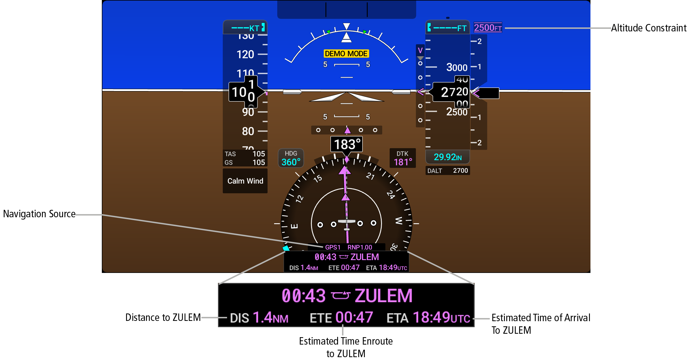

PFW Navigation Status
Navigation status for the active leg is displayed on the PFW. This status shall include the Navigation Mode, RNP Level or Approach Service Level, as well as distance and ETE to the next waypoint. Navigation prompts may also be displayed to inform of upcoming route/VNAV changes. Navigation Mode indicates which navigation source is providing the course data (e.g., FMS, VOR), the RNP level, and approach service level (LNAV, LNAV+V, L/VNAV, LP, LP+V, LPV, VISUAL).
188: FMS Navigation Information on the PFW
The following symbols may be displayed on the PFW to indicate navigation status:
