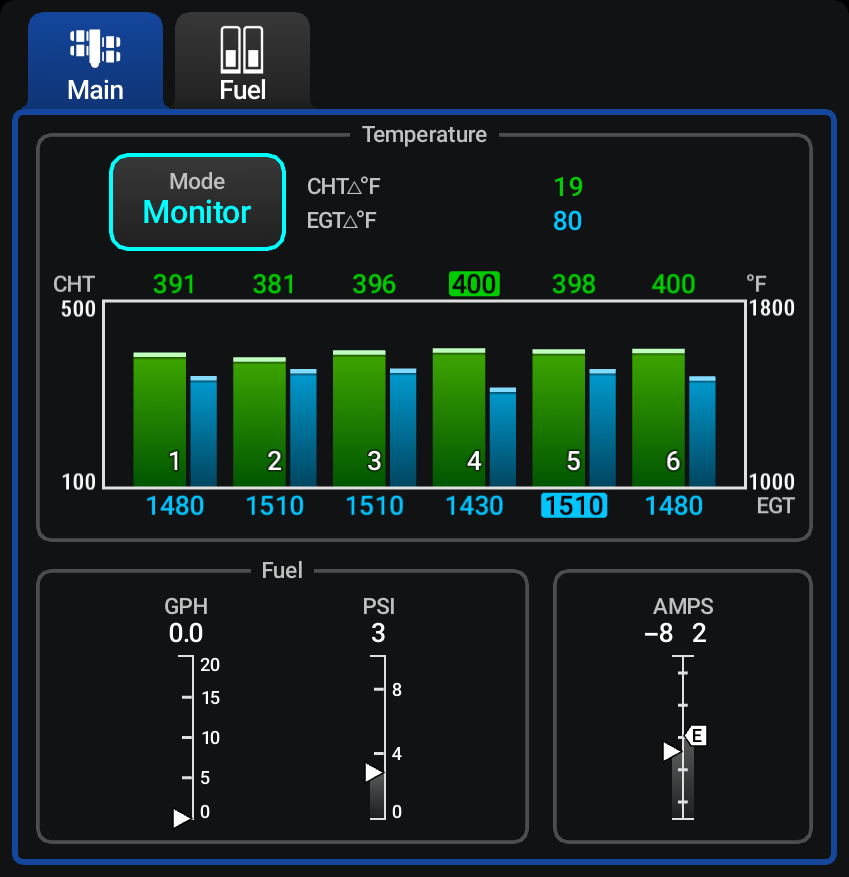

Monitor Mode
When in Monitor Mode, the application will display the current CHT/EGT temperatures, any TIT or Primary EGT temperatures, the current fuel information, and battery information.
Measured CHT is displayed in green above each bar, and the hottest cylinder is automatically detected and shown in black on a green background.
Measured EGT is displayed in cyan below each bar, and the hottest cylinder is automatically detected and shown in black text on a cyan background.
The CHT/EGT or TIT delta will be displayed at the top of the application window.
103: Monitor Mode on the Engine Application Page
