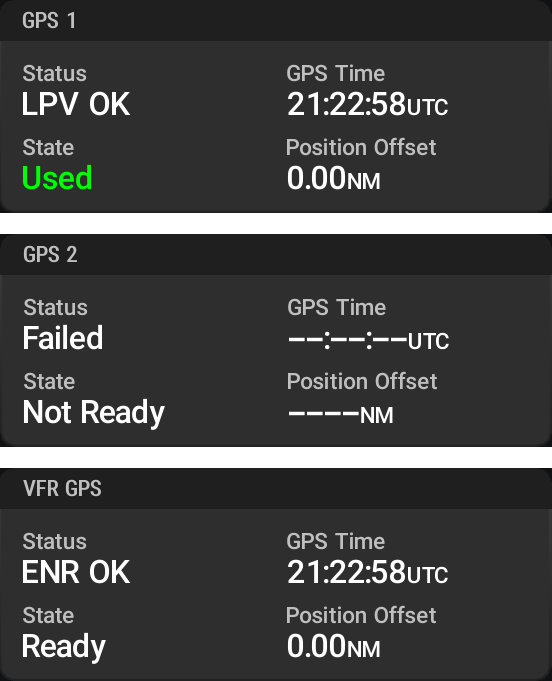

40: GPS Status
The GPS Status will display one of the following conditions:
  • ACQUIRING - The sensor is in the process of acquiring enough satellites for navigation.
  • ENR OK - The sensor is tracking a sufficient number of satellites to compute a 3 dimensional navigation solution suitable for GPS-based enroute operation.
  • TERM OK - The sensor is tracking a sufficient number of satellites to compute a 3 dimensional navigation solution suitable for GPS-based terminal operation.
  • LNAV OK - The sensor is tracking a sufficient number of satellites to compute a 3 dimensional navigation solution suitable for non-precision GPS-based approach operation.
  • LPV OK - The sensor is tracking a sufficient number of satellites to compute a 3 dimensional navigation solution and suitable for LNAV/VNAV and LPV approach operation using SBAS corrections.
