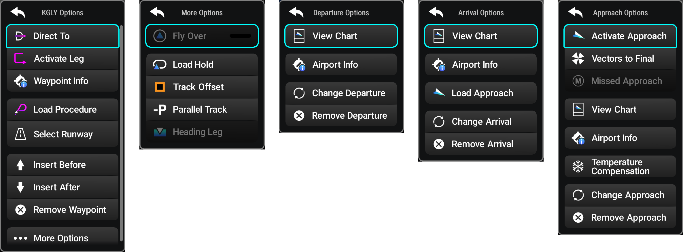

The 'Waypoint Options' can be accessed from any waypoint, and provides the means for the flight crew to modify the flight plan using that waypoint as a reference. Different options are available based on the type of waypoint selected. Reference the following figure and table for standard actions within the 'Waypoint Options'. Many of these actions and functions are discussed in more detail later in this section.
173: Waypoint Options
Waypoint/Airport Options:
  • Direct-To - Forego all previously established sequencing up to the Selected Waypoint and initiate navigation directly to the Selected Waypoint.
  • Activate Leg - Activate navigation sequencing from prior waypoint to the Selected Waypoint.
  • Waypoint Info - Displays the information page for the selected waypoint or airport.
  • Load Airway - Load a designated airway into the flight plan.
  • Load Procedure - Allows the pilot to load a departure, arrival, or approach procedure.
  • Select Runway - Select the desired runway to be added to the flight plan.
  • Insert Before - Insert a waypoint before the selected flight plan waypoint.
  • Insert After - Insert a waypoint after the selected flight plan waypoint.
  • Remove Waypoint - Remove the selected waypoint from the flight plan.
  • More Options - Opens a window of more options for the selected waypoint.
More Options:
  • Fly Over - If enabled, the system will dictate the waypoint be flown over (the system defaults to a 'fly-by' method for establishing paths between two concurrent legs (depending on the angle of the two legs)).
  • Load Hold - Establish a Hold at the Selected Waypoint. Touching the button opens a window to define the parameters of the Hold.
  • Track Offset - Establish a waypoint on the path to or from the Selected Waypoint at a determined radial and distance before or after the Selected Waypoint.
  • Parallel Track - Touching the button opens a window from which the flight crew can establish a flight path parallel to the current flight path.
  • Heading Leg - Establish a heading leg from the Selected Waypoint.
Departure Options:
  • View Chart - Opens the departure procedure chart view.
  • Airport Info - Opens the waypoint info page for the airport.
  • Change Departure - Allows the pilot to edit the departure procedure.
  • Remove Departure - Removes the departure from the flight plan.
Arrival Options:
  • View Chart - Opens the arrival procedure chart view.
  • Load Approach - Allows the pilot to load an approach into the flight plan.
  • Change Arrival - Allows the pilot to edit the arrival procedure.
  • Remove Arrival - Removes the arrival from the flight plan.
Approach Options:
  • Activate Approach - Activates the appraoch in the flight plan.
  • Vectors to Final - Suspends the flight plan and selects the FAF in the approach as the next active waypoint in the flight plan.
  • Missed Approach - Activates the missed approach hold point as the next active waypoint in the flight plan.
  • View Chart - Opens the approach chart view.
  • Temperature Compensation - Allows the pilot to adjust the temperature compensation for the approach procedure.
  • Change Approach - Allows the pilot to edit the approach procedure.
  • Remove Approach -Removes the approach procedure from the flight plan.
Certain actions within the 'Waypoint Options' Window may be subdued and unavailable for selection, depending on the context of that waypoint within the flight plan.
