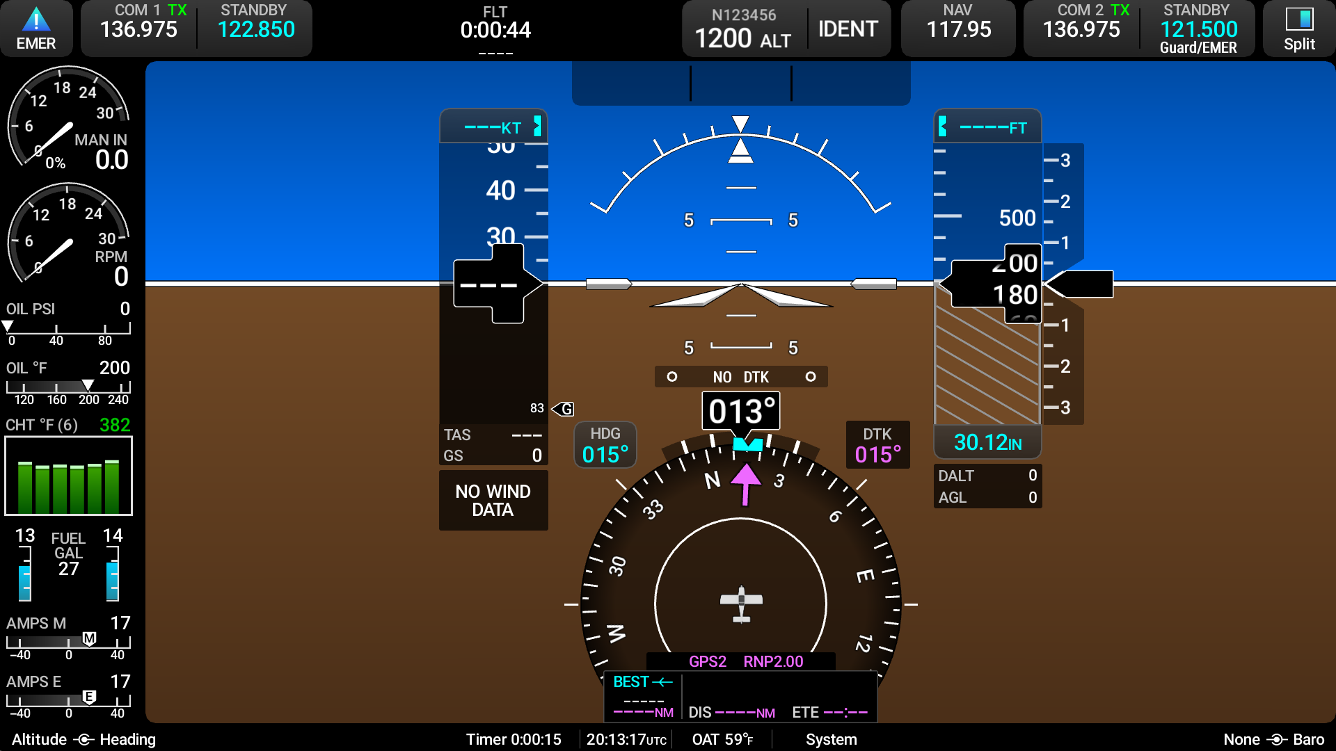

32: PFD in Full Screen Mode

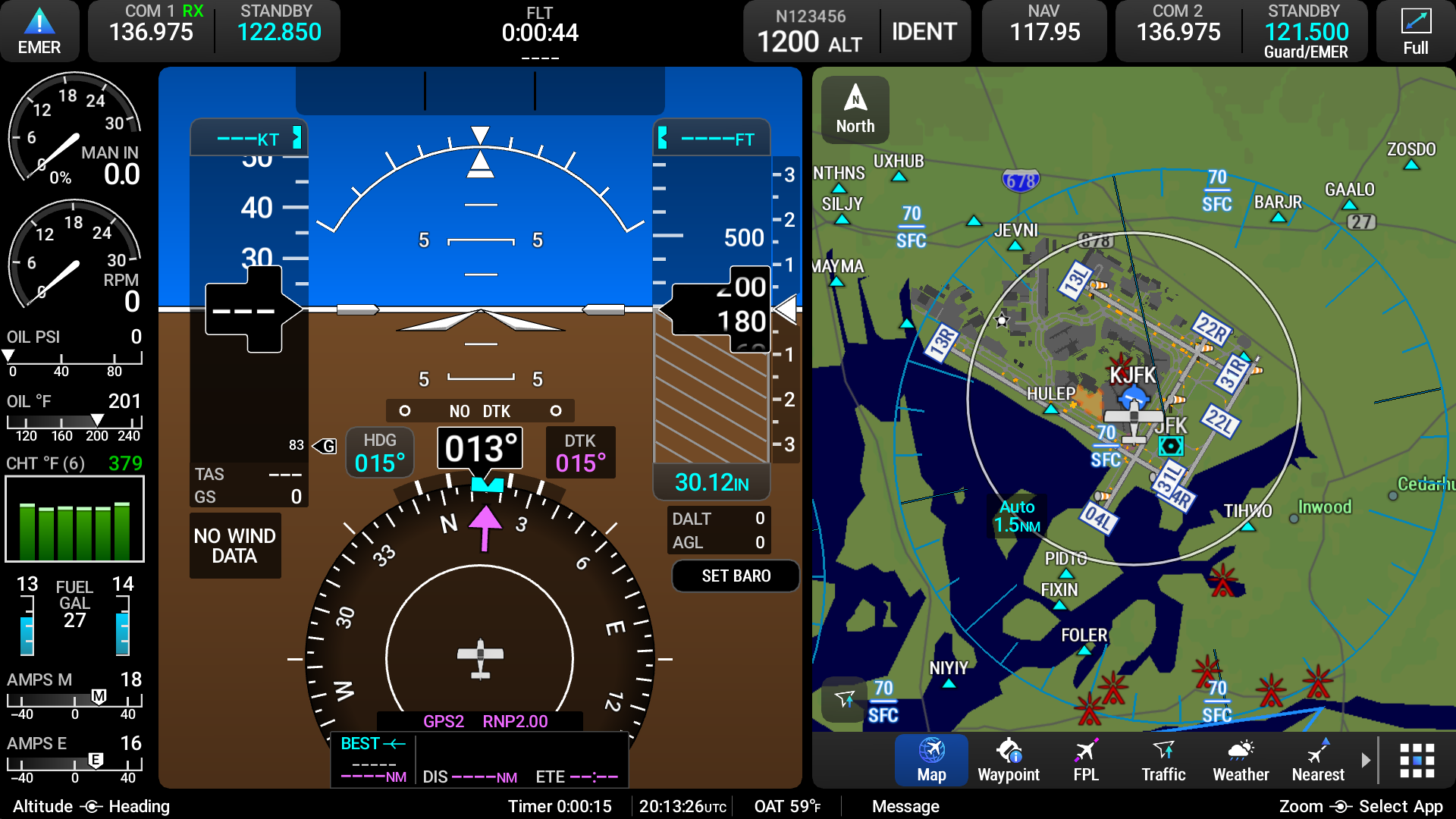

33: PFD in Split Screen Mode

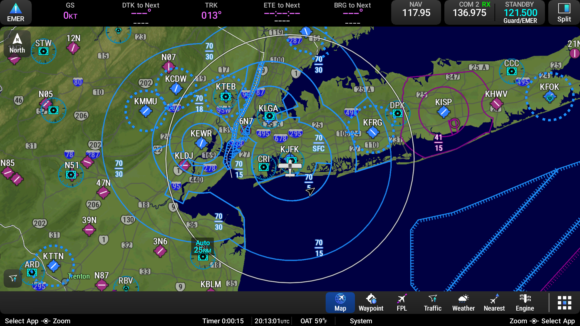

34: MFD in Full Screen Mode

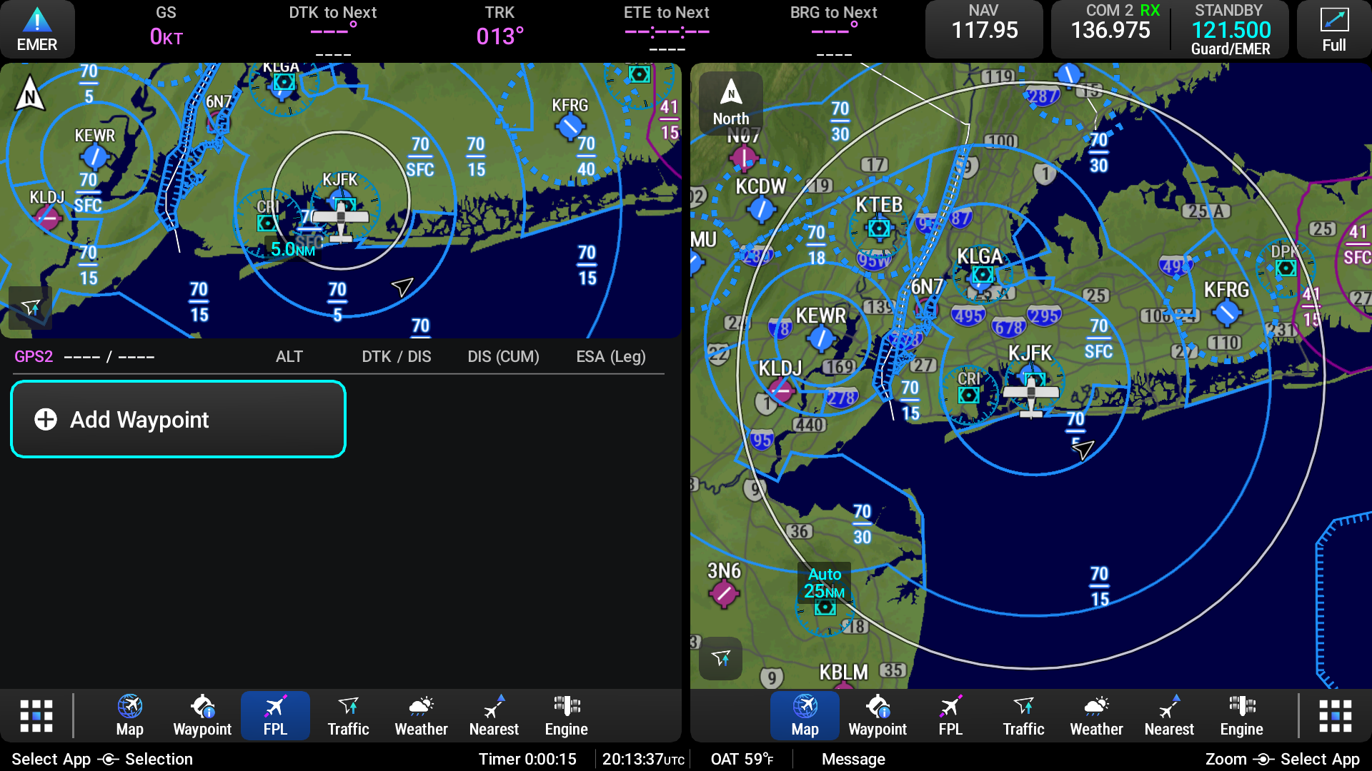

35: MFD in Split Screen Mode
