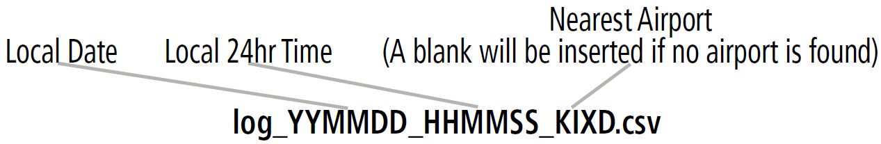

All flight data logged on a specific date is stored in a file named in a format which includes the date, time, and nearest airport identifier. The file is created automatically each time the system is powered on. The .csv file may be viewed with Microsoft Excel or other spreadsheet applications.

The file containing the recorded data will appear in the format shown in the following figure. This file can be imported into most computer spreadsheet applications.
302: Flight Data Log File Format
