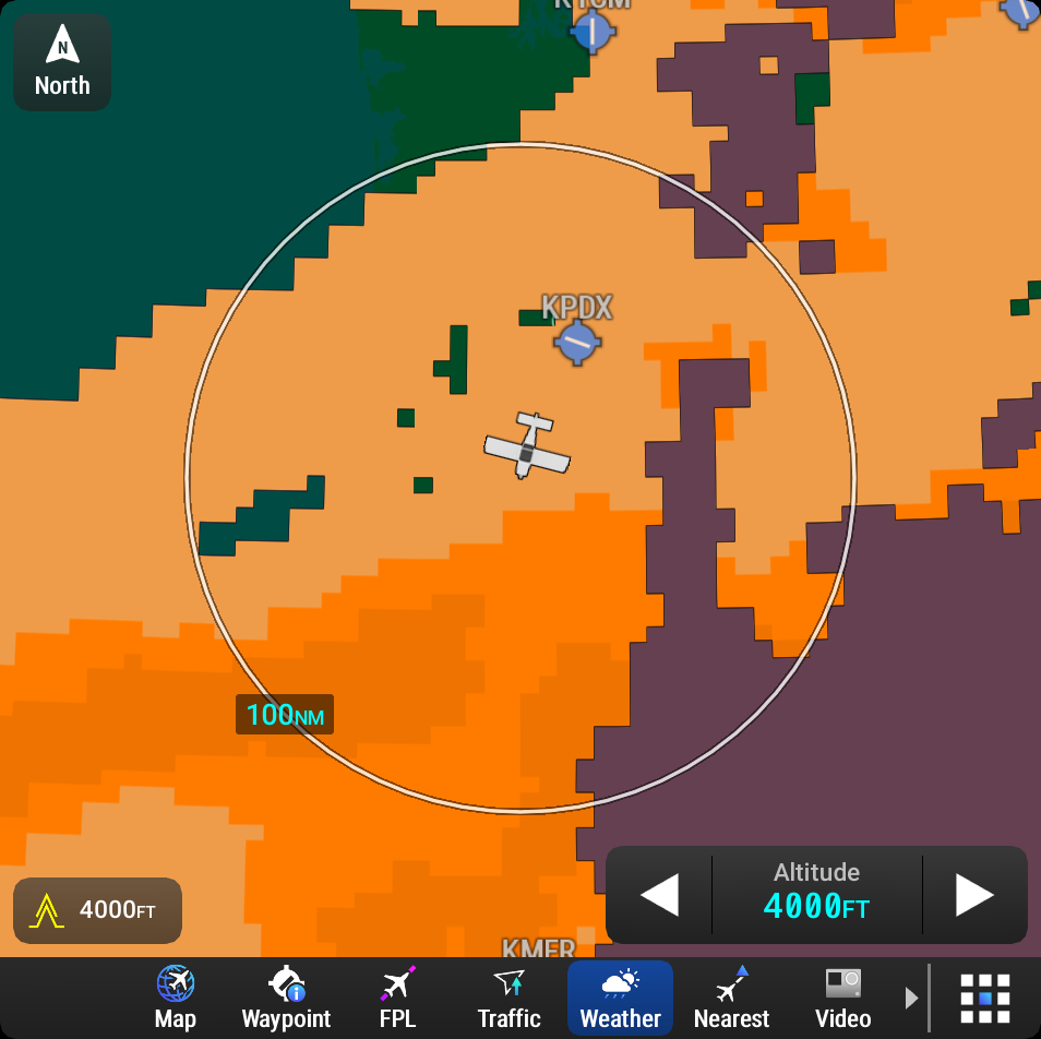

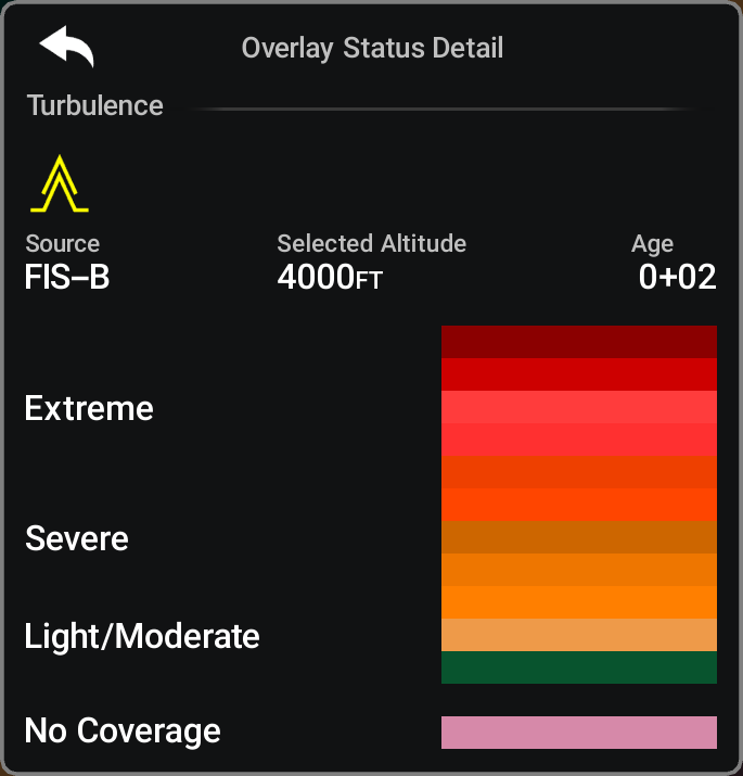

The FIS-B Turbulence weather product displays forecast turbulence every 2,000 feet starting 2000 feet MSL to 24,000 feet MSL. Turbulence data is intended to supplement AIRMETs and SIGMETs.
The FIS-B Turbulence weather product is not available in Alaska, Hawaii, Guam, or Puerto Rico.
237: Turbulance Weather Product
238: Turbulance Legend
