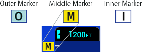

Marker Beacon Annunciations
Marker beacon annunciations are displayed on the PFW to the left of the Selected Altitude. Outer marker reception is indicated in cyan, middle in amber, and inner in white. Refer to the Marker Beacon Receiver section in the Audio & CNS chapter for more information on marker beacon annunciations.
