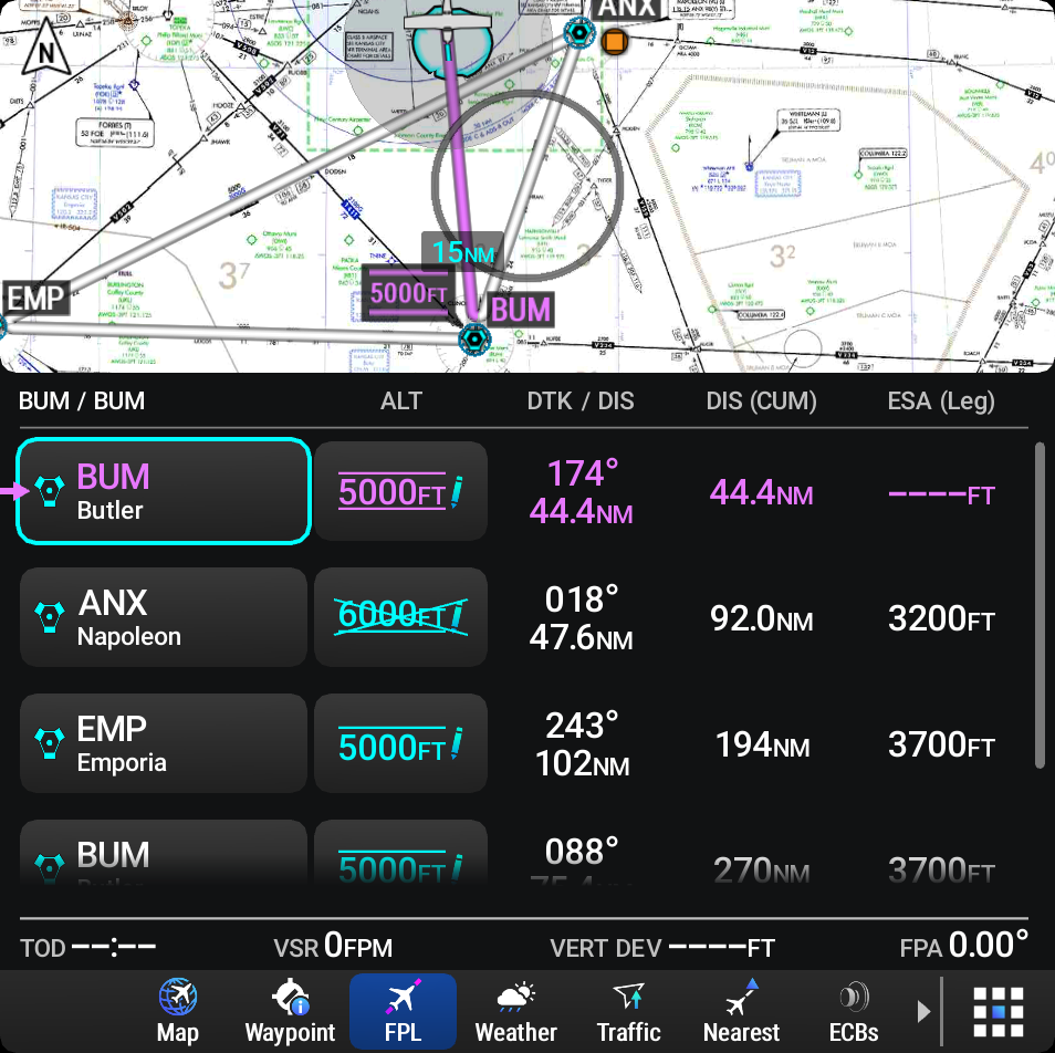

Flight Plan Data
Flight plan waypoints and leg data can be reviewed in the flight plan, on most map displays, and on the VSD. The flight plan shall contain the sequential list of flight plan waypoints (and any necessary leg identifiers) consisting of five columns. The first column shall contain a Waypoint Selection Button (or a Leg Type Button), and the other four data columns can be chosen using the MENU Softkey. The first column is frozen and the remaining columns may be scrolled left or right. The sequence of the flight plan may be reviewed by scrolling up or down.
174: Flight Plan Window and Corresponding Data Field Options
In addition to the waypoint (or leg type) identifier, each Waypoint Selection Button (or Leg Type Button) displays an icon for distinguishing waypoint and leg types. Furthermore, there may be additional information above (supertext) and below (subtext) the waypoint name on the Waypoint Selection Button to further emphasize characteristics of the waypoint or leg.
175: Example Flight Plan and Waypoint Selection Button
