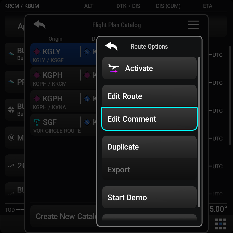

The 'Comment' Field (or name) of each flight plan can be changed to something that is useful for identification and sorting.
204: Changing the Comment for a Stored Flight Plan (Renaming)
  1. Navigate to the Flight Plan page.
  2. Press the MENU Softkey to open the 'Flight Plan Menu'.
  3. Touch the Flight Plan Catalog Button.
  4. Touch the selector button of the desired flight plan for the name to be changed, a 'Route Options' window.
  5. Touch the Edit Comment Button.
  6. Use the keypad to edit the name of the stored flight plan and touch the Enter Button to save the change and return to the flight plan catalog.
