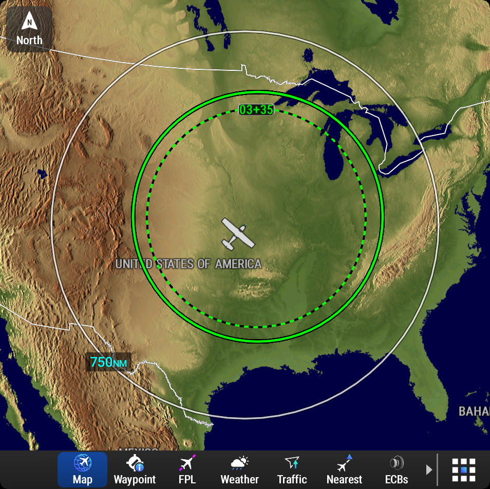

Fuel Range Ring
Map displays can show a fuel range ring which shows an estimate of the remaining flight distance. A dashed green circle indicates the selected range to fuel reserves. A solid green circle indicates the total endurance range. If only fuel reserves remain, the range is indicated by a solid amber circle. The range ring circle will appear offset from center based on calculations of the current fuel flow, ground speed, and the winds the aircraft are currently experiencing.
