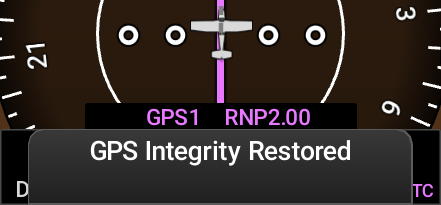

Loss of Integrity Monitoring — GPS integrity is insufficient for the current phase of flight.
Below HSI
Integrity OK — GPS integrity has been restored to within normal limits (annunciation displayed for 5 seconds).
