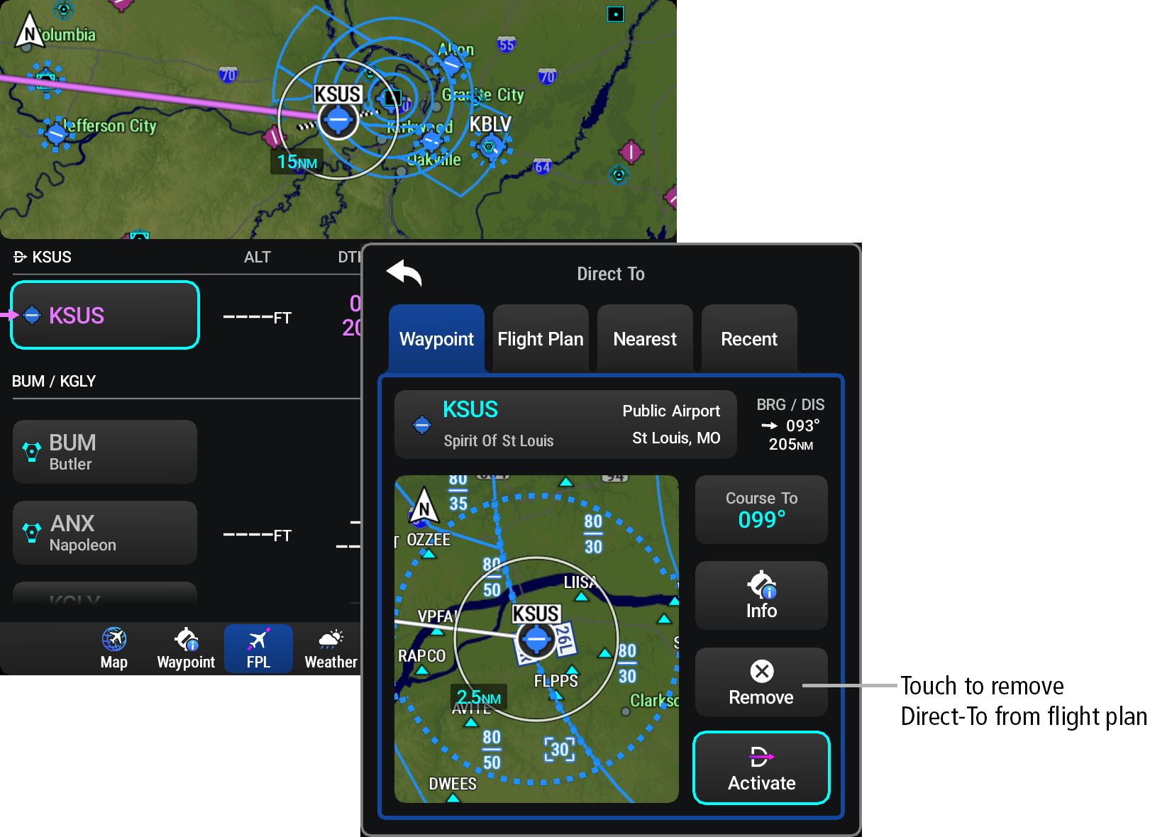

Removing Direct-To
Direct-to navigation can be canceled at anytime. The flight plan will resume the flight plan to the next sequenced waypoint in the flight plan after removing the Direct-To waypoint.
Parent Topic: Direct-To Navigation
