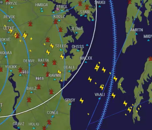

Datalink Lightning
The Lightning weather product shows the approximate location of cloud-to-ground lightning strikes. A strike icon represents a strike has occurred within a two-kilometer region. The exact location of the lightning strike is not displayed.
The FIS-B Lightning weather product is not available in Alaska, Hawaii, Guam, or Puerto Rico.
233: Lightning Weather Product
Touch the Status Button on ‘Datalink Weather’ to display weather legend(s) for enabled weather product(s). Scroll as necessary to view the information, then touch the Back Button.
