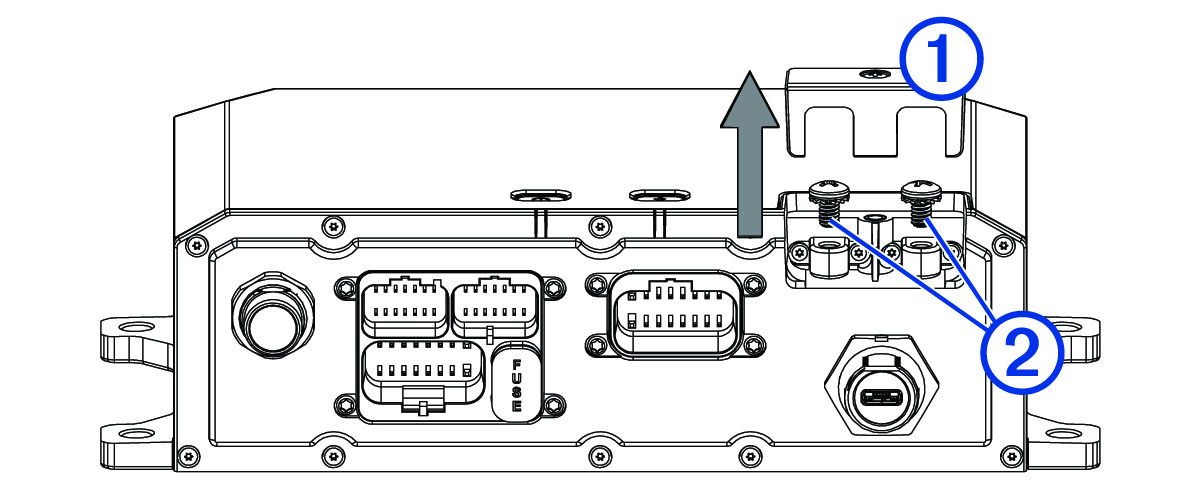

  1. Remove the terminal cover Callout number 1 using a Phillips screwdriver.
    Line drawing of the device with the terminal cover being removed with glyphs
  2. Remove the screws from the GND terminal and the +12V terminal Callout number 2.

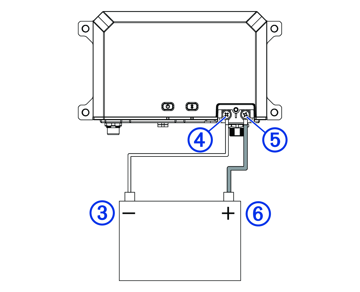

  3. Connect the large ring end of the included ground wire Callout number 3 to the negative terminal on the vehicle battery.
    Device power wiring with callouts
  4. Connect the small ring end of the ground wire to the GND terminal Callout number 4 on the device.
  5. Tighten the screw on the GND terminal.
    You should confirm the screws cannot be loosened by hand.
  6. Connect the small ring end of the included 12V cable to the +12V terminal Callout number 5 on the device.
  7. Tighten the screw on the +12V terminal.
    NOTICE
    Do not overtighten the screw on the +12V terminal to prevent damage to the terminal.
  8. Connect the large ring end of the 12V cable Callout number 6 to the positive terminal on the vehicle battery.
  9. Replace and tighten the terminal cover on the device.
