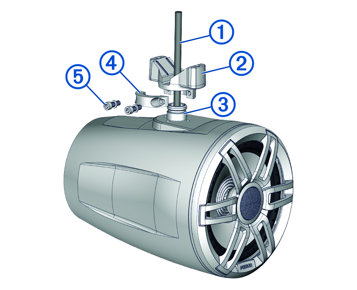

  3. Feed the cable Callout number 1 from the speaker through the base of the bracket Callout number 2.
    Bracket base install with callouts
  4. Place the base of the bracket over the mounting knob on the speaker Callout number 3.
  5. Using a 4 mm hex driver or hex key, attach the collar Callout number 4 to the base of the bracket using the two shorter screws and washers Callout number 5, but do not fully tighten them.
  6. Connect the speaker and LED wires ( Wiring).
  7. Place the connected wires in the channel on the base of the bracket Callout number 6, and route the wires along the roll bar.

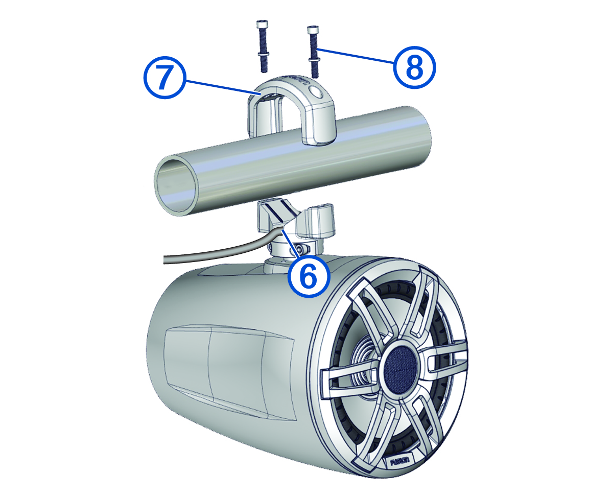

    Speaker being installed on a roll bar using the bracket with callouts
  8. Place the top of the bracket Callout number 7 over the roll bar, and hold it against the base of the bracket.
  9. Using a 5 mm hex driver or hex key, attach the top of the bracket to the base of the bracket using the two longer screws and washers Callout number 8, but do not fully tighten them.
  10. Adjust the angle of the speakers, and tighten all of the screws to secure the speaker to the roll bar, observing these maximum torque measurements:
    • For the longer screws that secure the bracket to the roll bar Callout number 8, do not tighten to more than 4 N-m (2.95 lbf-ft.).
    • For the shorter screws that secure the bracket to the speaker Callout number 5, do not tighten to more than 2.5 N-m (1.84 lbf-ft.).
