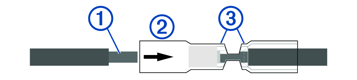

  1. Using wire strippers, strip 6 mm (1/4 in.) off the end of each bare wire.
  2. If necessary, twist the strands of each wire Callout number 1 clockwise to bundle them together.
    Heat shrink crimp connector assembly with callouts
  3. Insert one bare wire into one end of the heat-shrink crimp connector Callout number 2.
    The bare wires are not secure until they are crimped and sealed.
  4. Insert the corresponding bare wire into the other end of the heat-shrink crimp connector.
  5. Using pliers, crimp both sides of the center of the connector Callout number 3 to secure the connection.
  6. Using a heat gun, apply heat to the heat-shrink crimp connector until the connector is sealed to the wires.
    Do not apply heat to the wires directly.
