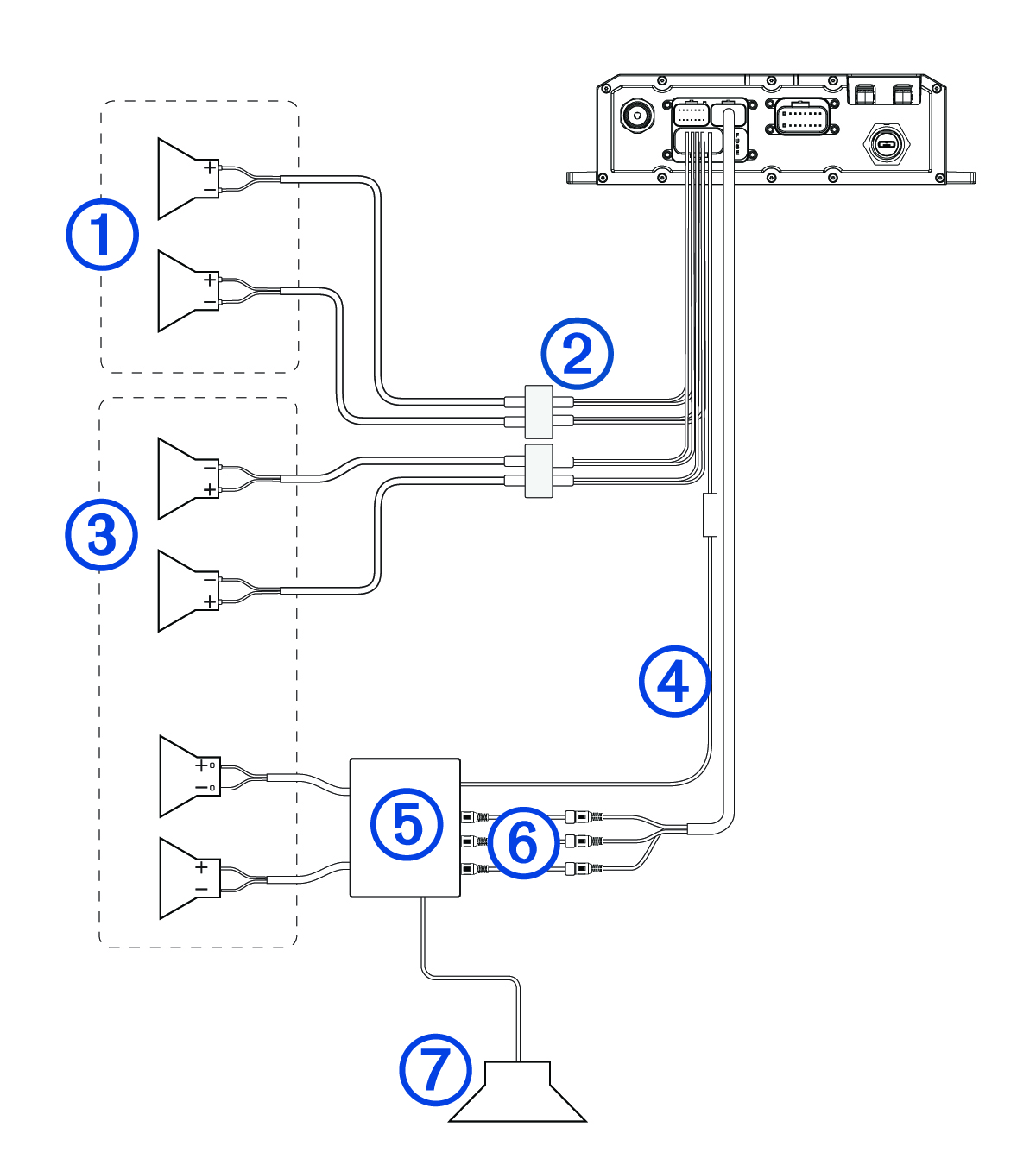

Complete System Wiring
This diagram illustrates a system installation with an external amplifier and subwoofer connected to the stereo using a line out.
NOTE: You can also connect speakers to the speaker wires for the internal stereo amplifier while using an external amplifier connected to the line out. Adjusting the volume affects speakers connected to the internal amplifier and speakers connected to the line out. This may result in uneven volume levels.
Device wiring diagram with callouts
Item
Description
Callout number 1
Zone 2 speakers
Callout number 2
Water-tight connection
Callout number 3
Zone 1 speakers
Callout number 4
Amplifier-on signal wire
Callout number 5
Powered amplifier
Callout number 6
Line out and subwoofer out
Callout number 7
Subwoofer
