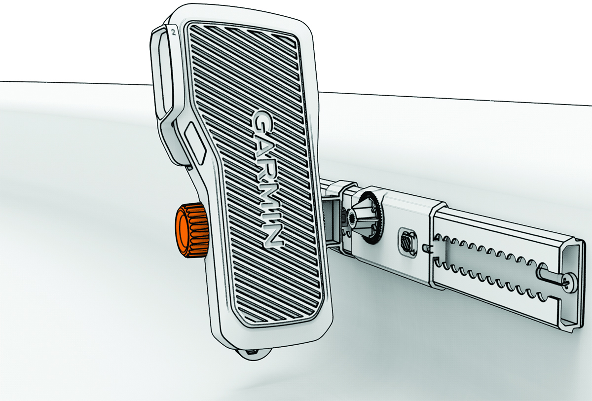

Attaching the Pedals to the Rails
  1. Align the screw on the outside of the pedal with the threaded socket in the pedal carriage on the rail, and turn the knob on the other side of the pedal, clockwise, to attach the pedal to the pedal carriage.
    Installing the pedal on the rail

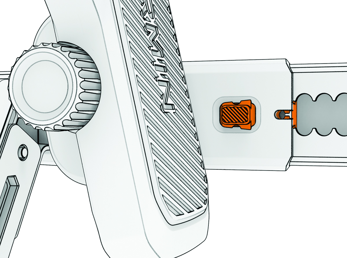

  3. If necessary, push the button on the pedal carriage and slide it along the rail to position the pedal at a comfortable distance.
    Moving the pedal carriage
    NOTICE
    Do not move the pedal carriages all the way to either end of the pedal rail. If the pedal carriage overlaps one of the pedal rail mounting screws, it may become difficult to move it.
