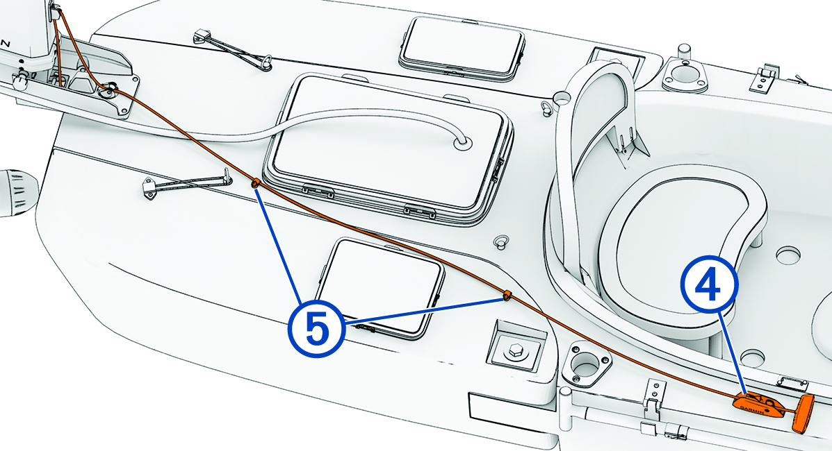

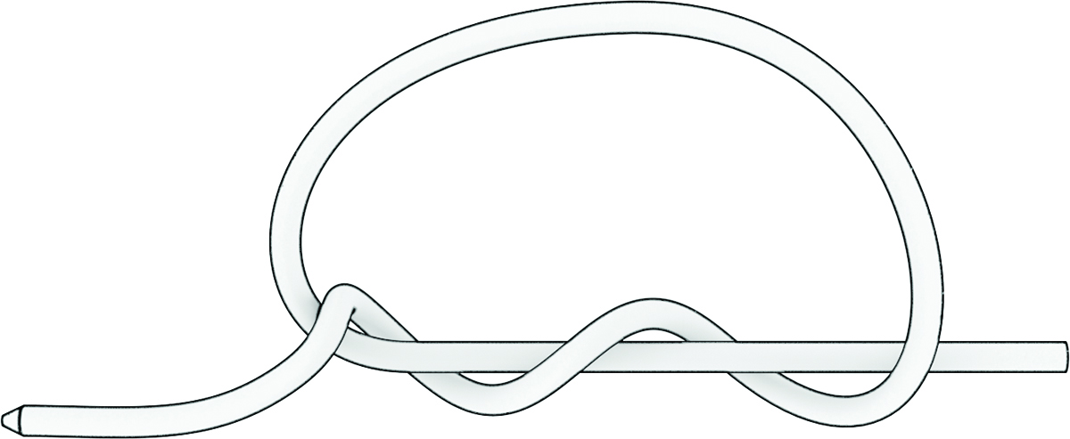

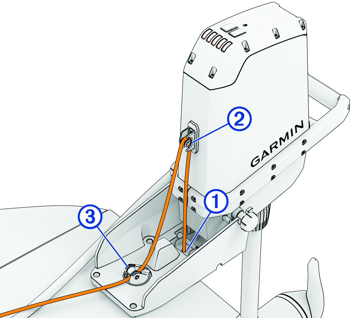

Installing the Pull Rope Feed one end of the rope through the metallic release latch in the mount 1. Tie the end of the rope under the mount into a stopper knot to prevent the rope from pulling out through the release latch. Feed the rope up through the eyelet on the front of the motor 2. Guide the rope down and feed it through the swivel pulley on the mount 3. Select a mounting location for the rope cleat 4 just in front of the seat and off to one side. Select mounting points for the pad eyes 5, which guide the rope from the mount to the cleat. Install the pad eyes and the cleat (Installing the Pad Eyes and Cleat). Route the rope through the pad eyes and the cleat. Install the rope handle (Installing the Rope Handle). Child Topics:Installing the Pad Eyes and CleatInstalling the Rope HandleHomeInstalling the Pull Rope
