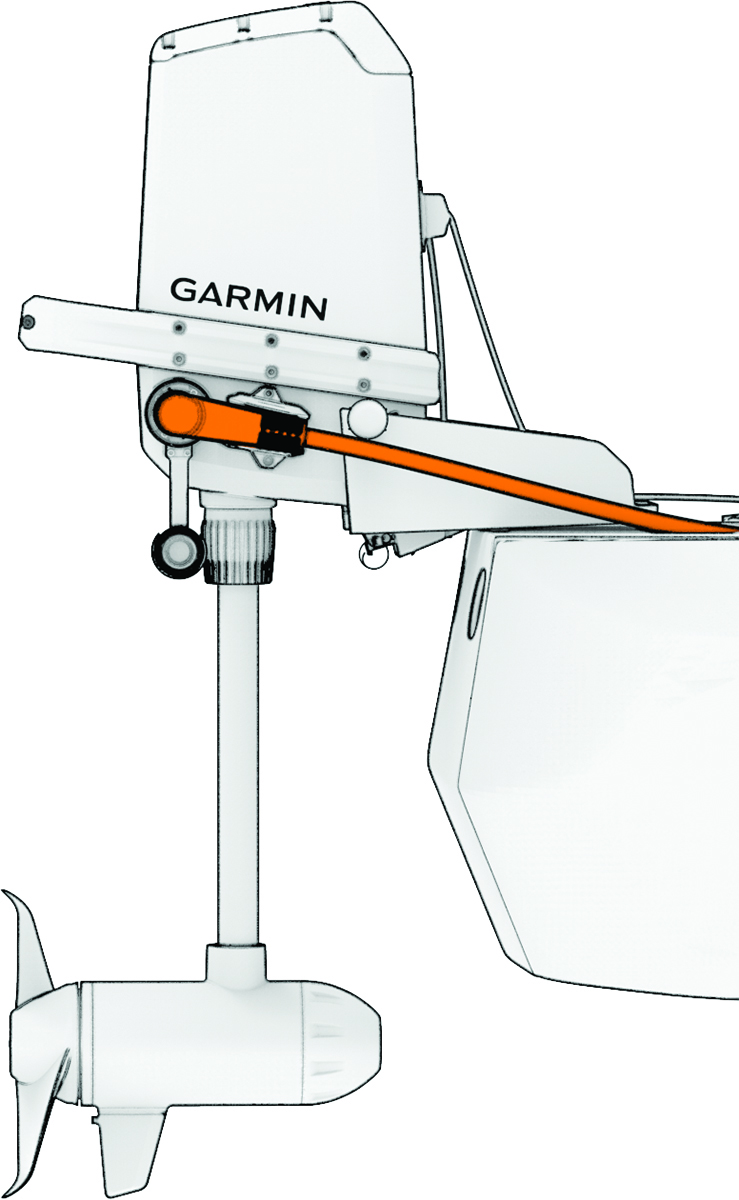

  1. Connect the trolling motor power cable to the battery, routing the red (+) wire through a circuit breaker rated for 40 A (continuous).
  2. Turn the weather cap on the trolling motor power connector a quarter-turn counterclockwise to expose the power connector.
  3. Insert the power cable connector, with the cable approximately parallel to the kayak, and push until it is fully inserted.
    NOTE: Make sure the locking collar on the power cable connector is in the unlock position, before connecting it to the motor.
    Motor with power cable connected
    The power cable strain relief rests against the cradle on the motor housing.
  4. Turn the locking ring on the power cable connector a quarter-turn clockwise to lock it in place.
