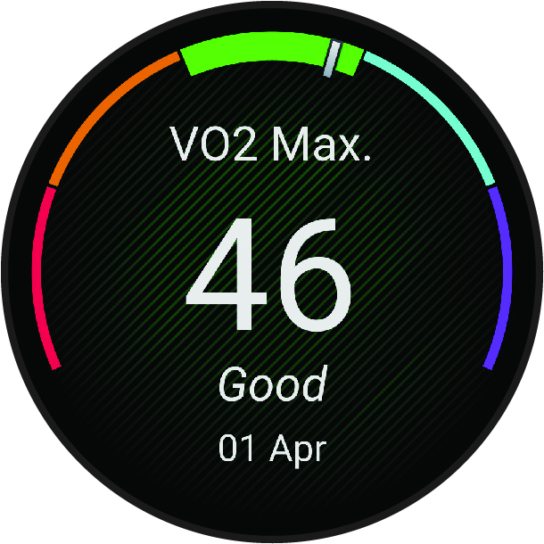

VO2 max. is the maximum volume of oxygen (in milliliters) you can consume per minute per kilogram of body weight at your maximum performance. In simple terms, VO2 max. is an indication of athletic performance and should increase as your level of fitness improves. The Forerunner® device requires wrist-based heart rate or a compatible chest heart rate monitor to display your VO2 max. estimate.
On the device, your VO2 max. estimate appears as a number, description, and position on the color gauge. On your Garmin Connect™ account, you can view additional details about your VO2 max. estimate, such as where it ranks for your age and sex.
VO2 max. data
Purple Purple
Superior
Blue Blue
Excellent
Green Green
Good
Orange Orange
Fair
Red Red
Poor
