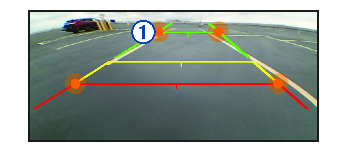

  3. Drag the circles on the corners of the guidance lines 1, or tap the arrows until they match the angle and position of the curb, driveway, or parking stall lines.
    The guidance lines should appear directly on top of your reference points.
    The red or orange section of the guidance lines should align with the rear of your vehicle.
    Screenshot of guidance lines with a callout
