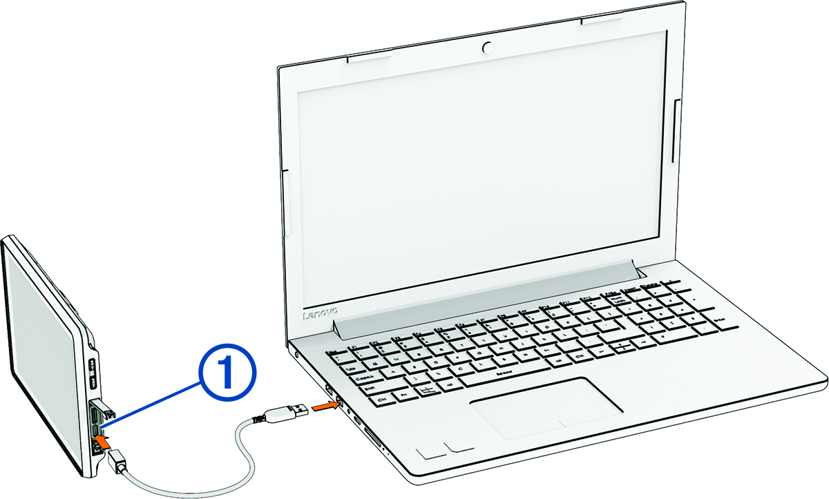

  3. Connect your device to your computer using a USB-C® cable.
    The small end of the cable connects to the USB-C port 1 on your Tread® 2 device, and the large end connects to an available USB port on your computer.
    Device connected to a laptop with a USB cable and with a callout
