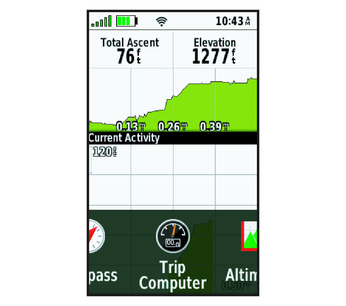

Changing the Page Sequence
  1. Press MENU twice to open the main menu.
  2. Select Setup > Menus > Page Sequence > Edit Page Sequence.
  3. Select a page.
  4. Select an option:
    • To move the page up or down in the list, select Move.
    • To add a new page to the page sequence, select Insert, and select a category.
    • To remove a page from the page sequence, select Remove.
    TIP: You can press PAGE to view the page sequence.
    Page sequence
