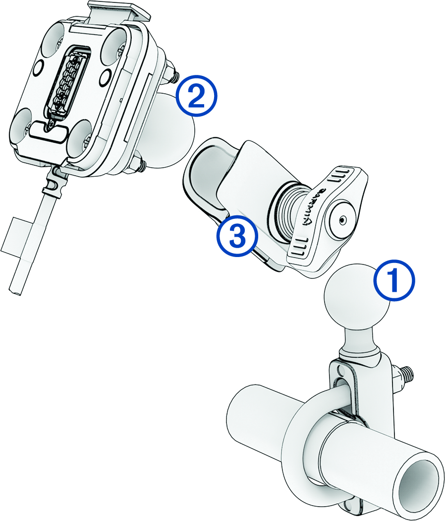

Attaching the Base Plate to the Handlebar Base Align the ball of the handlebar base 1 and the ball of the base plate 2 with each end of the double-socket arm 3. Insert the ball of the handlebar base 1 and the ball of the base plate 2 into the double-socket arm 3. Tighten the knob slightly. Adjust for optimal viewing and operation. Tighten the knob to secure the mount. Parent Topic: Installing the Handlebar BaseHomeInstallationMounting Your Device in a MotorcycleInstalling the Handlebar BaseAttaching the Base Plate to the Handlebar Base
