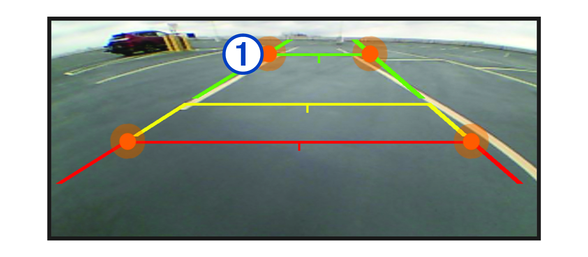

  1. Position the vehicle with one side closely aligned to a curb, driveway, or parking stall lines.
    You may want to position the vehicle in the center of a parking stall, and then pull forward into the next stall. This allows you to use the parking stall lines in the rear of the vehicle as reference points for alignment.
    The curb, driveway, or parking stall lines should be clearly visible on the device.
  2. Select an option:
    • From the camera view, tap the screen, and select Guidance lines symbol.
    • From the camera view, select Menu > Adjust Video.
  3. Drag the circles on the corners of the guidance lines 1, or tap the arrows until they match the angle and position of the curb, driveway, or parking stall lines.
    The guidance lines should appear directly on top of your reference points.
    The red or orange section of the guidance lines should align with the rear of your vehicle.
    Guidance line alignment with a callout
  4. If necessary, reposition the vehicle with the other side closely aligned to a curb, driveway, or parking stall lines, and repeat the alignment process.
    You should attempt to keep the guidance lines symmetrical, even if your vehicle is not in perfect alignment with the curb, driveway, or parking stall lines.
  5. Select Check symbol after alignment is complete.
