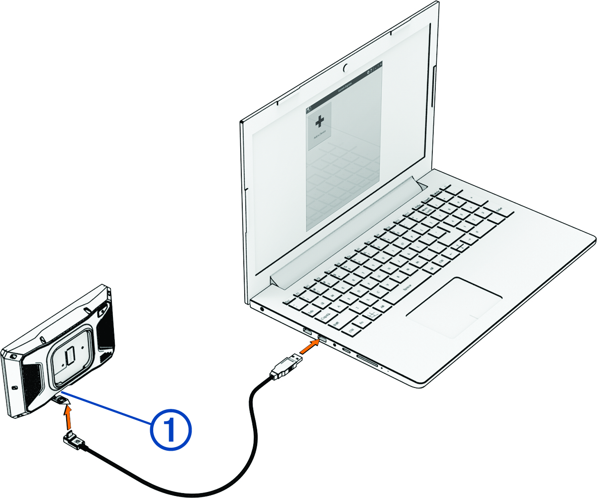

  3. Connect your device to your computer using a USB cable.
    The small end of the cable connects to the USB port 1 on your zūmo® device, and the large end connects to an available USB port on your computer.
    Device connected to a laptop with a USB cable and with a callout
  4. From your zūmo device, select Tap to Connect to Computer.
