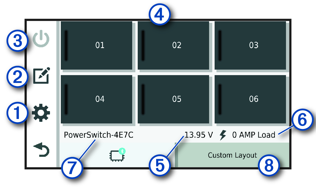

Garmin PowerSwitch App
Garmin Power Switch app overview with callouts
1 Settings
Opens the app settings menu
2 Edit field
Enters editing mode to customize the app layout and functions
3 Turn off
Turns off all outputs
4 Power buttons
Activates each connected output
5
Displays input voltage
6
Displays the total amperage of the selected Garmin PowerSwitch™ device
7
Displays the device name
8
Displays Garmin PowerSwitch device tabs and custom layout tabs
