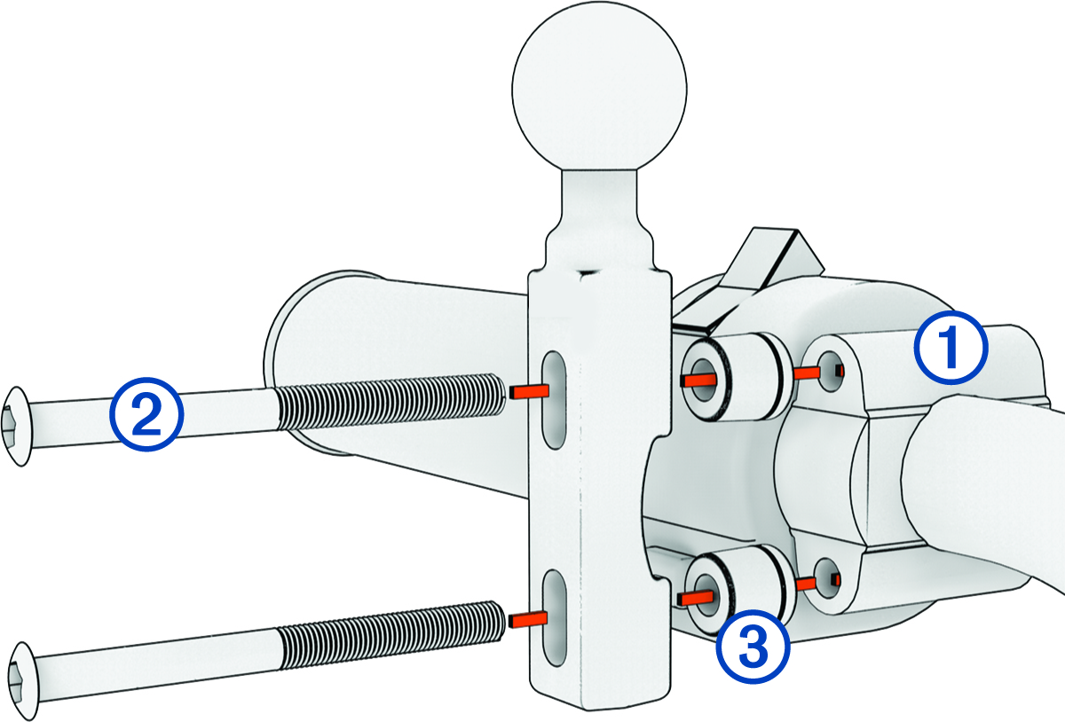

Installing the Handlebar Base to the Clutch-Clamp or Brake-Clamp Brackets Remove the two factory bolts on your clutch-clamp or brake-clamp bracket 1. NOTE: Both 1/4 in. standard and M6 bolts are included. Match the size of the factory bolts on your clutch-clamp or brake-clamp bracket. Thread the new bolts 2 through the handlebar base, spacers 3, and clutch-clamp or brake-clamp bracket. Tighten the bolts to secure the handlebar base. Parent Topic: Installing the Handlebar BaseHomeInstallationMounting Your Device in a MotorcycleInstalling the Handlebar BaseInstalling the Handlebar Base to the Clutch-Clamp or Brake-Clamp Brackets
