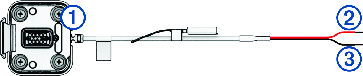

Device mount and power cable with callouts
1
Motorcycle mount connector
2
10 to 30 Vdc system power (red)
3
System ground (black)
