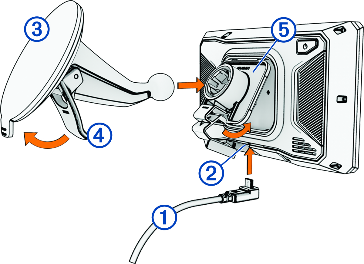

  1. Plug the automotive power cable 1 into the port 2 on the device.
    Exploded view of the automobile mount installation with a callout
  2. Remove the clear plastic from the suction cup 3.
  3. Clean and dry your windshield and the suction cup with a lint-free cloth.
  4. Press the suction cup to the windshield, and flip the lever 4 back toward the windshield.
  5. Snap the cradle 5 onto the suction cup arm.
  6. Fit the top of your device into the cradle.
  7. Press the device into the cradle until it snaps into place.
  8. Plug the other end of the automotive power cable into a power outlet.
