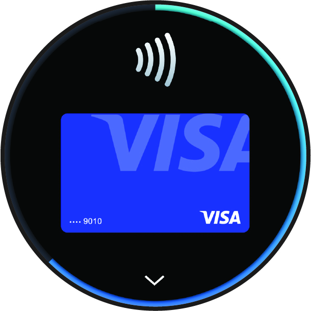

    Your most recently used payment card appears.
    Garmin Pay data
  4. If you have added multiple cards to your Garmin Pay™ wallet, swipe to change to another card (optional).
  5. Within 60 seconds, hold your watch near the payment reader, with the watch facing the reader.
