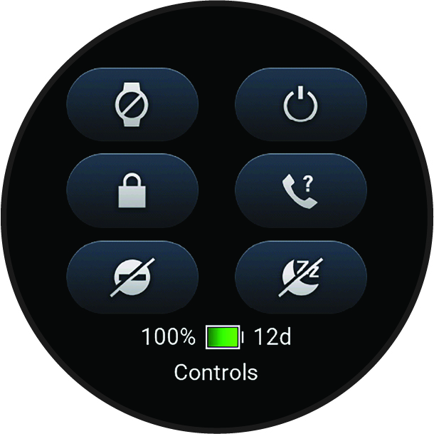

Controls
The controls menu lets you quickly access watch features and options. You can add, reorder, and remove the options in the controls menu (Customizing the Controls Menu).
From any screen, press Line drawing of the watch with a top button callout and swipe down from the top of the screen.
Controls menu data
