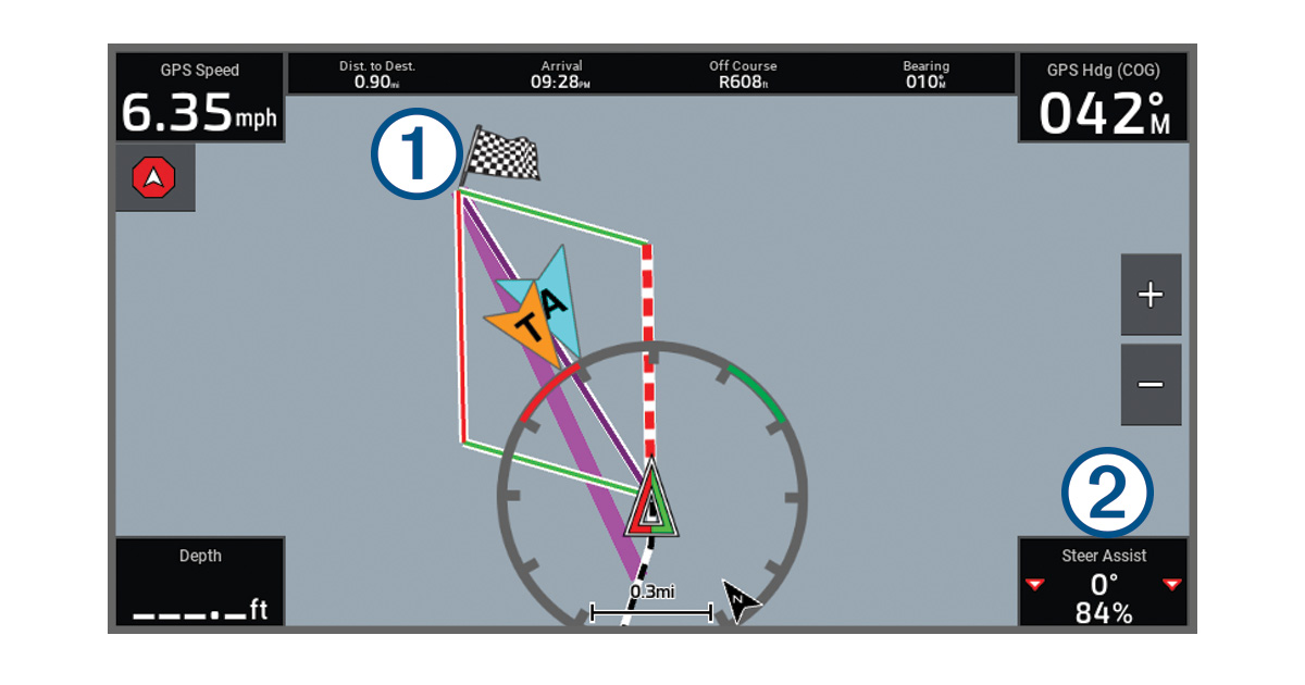

Steer Assist is a set of sailing features provided to help you steer on the optimal course while sailing. You must select or import a polar table before you can use the Steer Assist feature ( Polar Tables).
NOTE: Steer Assist is enabled automatically when you select or load a polar table. To deactivate Steer Assist, select Settings menu > Preferences > Navigation > Steer Assist.
Sail assist feature with callouts
1
Navigation turn or destination:
  • The wide magenta line indicates the initial route line to the next turn or the destination.
  • The thin purple line from your vessel to the next turn or to the destination indicates your present bearing to the next turn or to the destination.
  • The port and starboard laylines are determined by the polar table you are using.
  • The bold dashed line (can be red, green, or purple) indicates the recommended Steer Assist bearing to follow.
2
Steer Assist data field:
  • The first number listed indicates how you should turn to align with the suggested optimal course for the present maneuver. A value of 0° indicates that you are on course.
  • The percentage indicates your present speed as compared to the ideal speed for the conditions. If the number is lower than 100%, you should consider adjusting the trim to increase your speed.
  • The triangle or triangles on the side also provide guidance based on the color and shading:
    • A red triangle or triangles indicate that you are aligned with the port layline.
    • A green triangle or triangles indicate that you are aligned with the starboard layline.
    • A magenta triangle or triangles indicate that you are aligned with the bearing to the next turn or destination.
    • A triangle with a white center indicates that you are within 3° of the optimal course and should maintain your heading.
    • A solid triangle or triangles indicate that you are off course by more than 3° and should adjust your heading.
