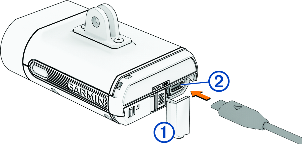

  1. Pull up the weather cap Callout number 1 from the USB port Callout number 2.
    Back view of the device with callouts
  2. Plug one end of the cable into the USB port on the device.
  3. Plug the other end of the cable into a computer USB port.
