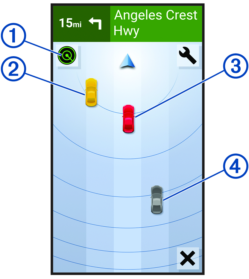

The radar information appears on the active data screen.
Radar data with callouts
The vehicle positions change color based on threat level. The status icon 1 indicates the radar sensor status. A yellow vehicle 2 indicates a vehicle is approaching in your blind spot to the left or right of your motorcycle. A red vehicle 3 indicates a vehicle is approaching rapidly or presents a danger. The rear alert light flashes red three times when this occurs. A gray vehicle 4 indicates a vehicle is approaching from a distance.
