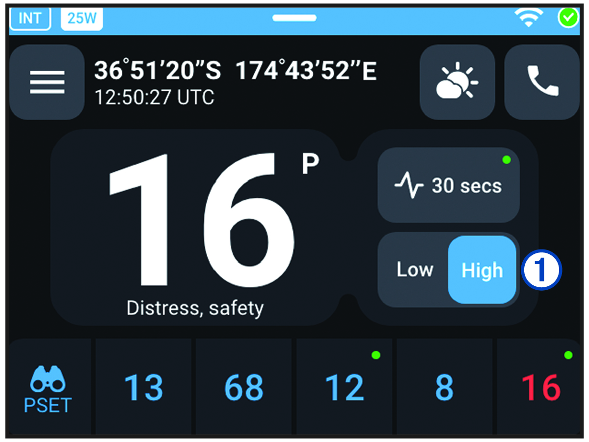

Changing Transmit Power Using the Touchscreen
Select 1.
VHF Radio screen with callout.
If the current VHF channel allows it, the radio switches between high-power mode and low-power mode.
