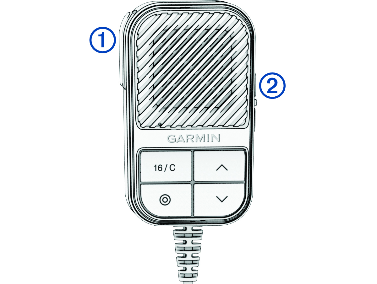

Fist Mic
Fist mic with callouts
16/C
Press to switch between the current VHF channel and channel 16.
NOTE: Pressing the 16/C button turns off watch modes automatically (Watch Modes).
Concentric circles
Press to switch between low power (1 W) and high power (25 W) (not available on some VHF channels).
Up arrow
Down arrow
Press to change the current VHF channel.
1
Push-to-talk (PTT) button
Hold to transmit on the current VHF channel.
2
Volume buttons
Press + or − to increase or decrease the fist mic speaker volume.
