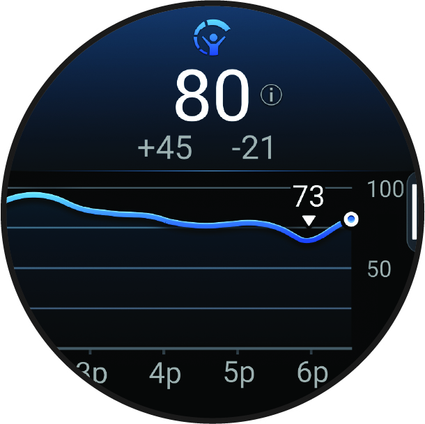

  2. Select the glance to view a graph of your latest Body Battery data.
    Body Battery data
    You can tap More information symbol for more information. You can select Menu symbolfor menu options.
