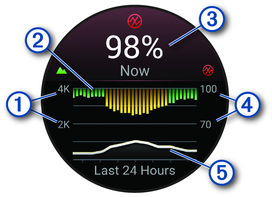

Pulse ox data with callouts
1
The elevation scale.
2
A graph of your average oxygen saturation readings for the last 24 hours.
3
Your most recent oxygen saturation reading.
4
The oxygen saturation percentage scale.
5
A graph of your elevation readings for the last 24 hours.
