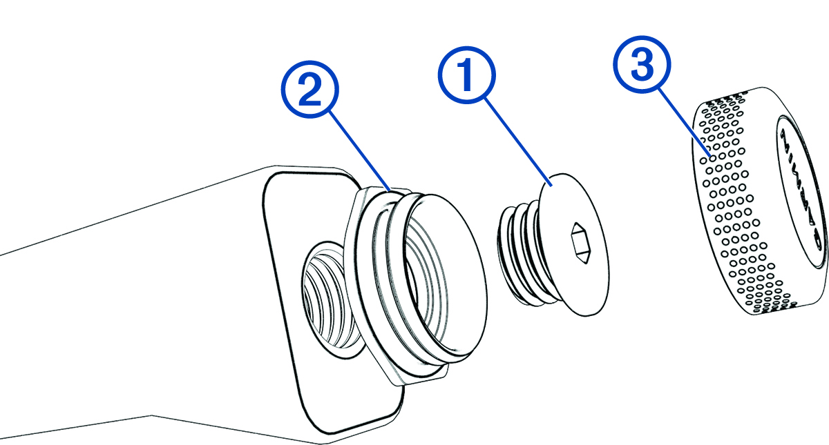

  1. Using a 4 mm (3/16") hex wrench, remove the screw on the end of the SuperStroke® grip 1.
    SuperStroke grip installation view with numbered callouts
  2. Unscrew the lower housing 2 from the Approach® CT1 - SuperStroke Edition device 3.
  3. Secure the housing to the end of the grip using the SuperStroke screw and hex wrench.
  4. Screw the device onto the housing.
    NOTE: Ensure that the device is fully tightened onto the end of the grip. There is a small notch in the housing that should line up with a notch in the device when it is fully tightened.
