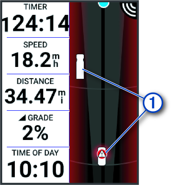

You can add a radar data screen to remotely control your connected Varia RearVue radar device and view radar data. The radar data screen shows a graphical representation of the road behind you, as you are riding. Each icon 1 represents an approaching vehicle. For more information, see the manual for your radar accessory.
Radar screen timer with data
The vehicle icon moves up and across the screen as the vehicle approaches you, representing the vehicle's position relative to you. The radar calculates a threat level based on vehicle size, speed, and other factors (Enabling the Green Threat Level Tone).
Icon Threat Level
Yellow warning symbol Mid level
Red warning symbol High level
TIP: You can add five data fields to this screen (Editing a Data Screen).
