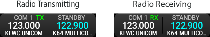

Transmit and Receive Indications
When receiving a transmission, 'RX' is displayed on the COM button. 'TX' is also displayed on the COM button while transmitting.
115: COM Annunciations (TX/RX)
