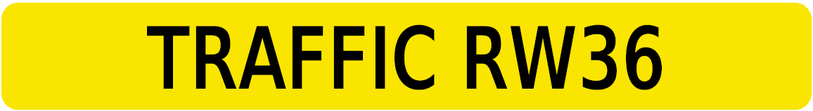

Runway Caution Indication — An yellow Caution Level Alert on the PFW and the traffic map when a runway collision hazard exists.
The system will provide an yellow Caution Level Alert on the PFW and the traffic map when a runway collision hazard exists where traffic and ownship are converging at high speed and immediate flight crew awareness of the conflict is required. The aural voice alert “Traffic Runway” will include the specific runway number (ex.“Traffic Runway 01”). Caution alerts are provided when either ownship taxi speed is above 30 KIAS or other participating traffic taxi speed is above 40 KIAS and a collision risk is expected to occur on a runway within 35 seconds. ROA Alerts are suppressed during takeoff when ownship has reached a ground speed greater than 60 KIAS or GPS ground speed (whichever is higher).

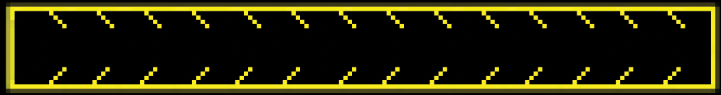

ROA Occupied Runway Highlight Navigation Maps |
Description |
ROA Occupied Runway Highlight (SVT) |
Runway Status Indication (RSI) |
Not Shown on SVT |
Runway Caution Alert |
Runway Warning Alert | ![]() |
PFW ROA Alert Annunciation |
Description |
SURF IA Aural Voice Alert |
Runway Advisory Alert |
None |
"Traffic Runway ##" |
