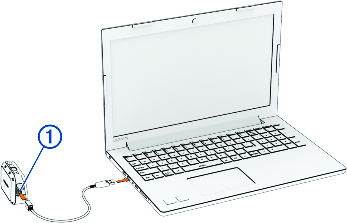

  3. Connect your chronograph to your computer using a USB-C® cable.
    The cable connects to the USB-C port 1 on your Xero® C2 chronograph, and the other end of the cable connects to an available USB-C port on your computer.
    Device connecting to a computer with a callout
