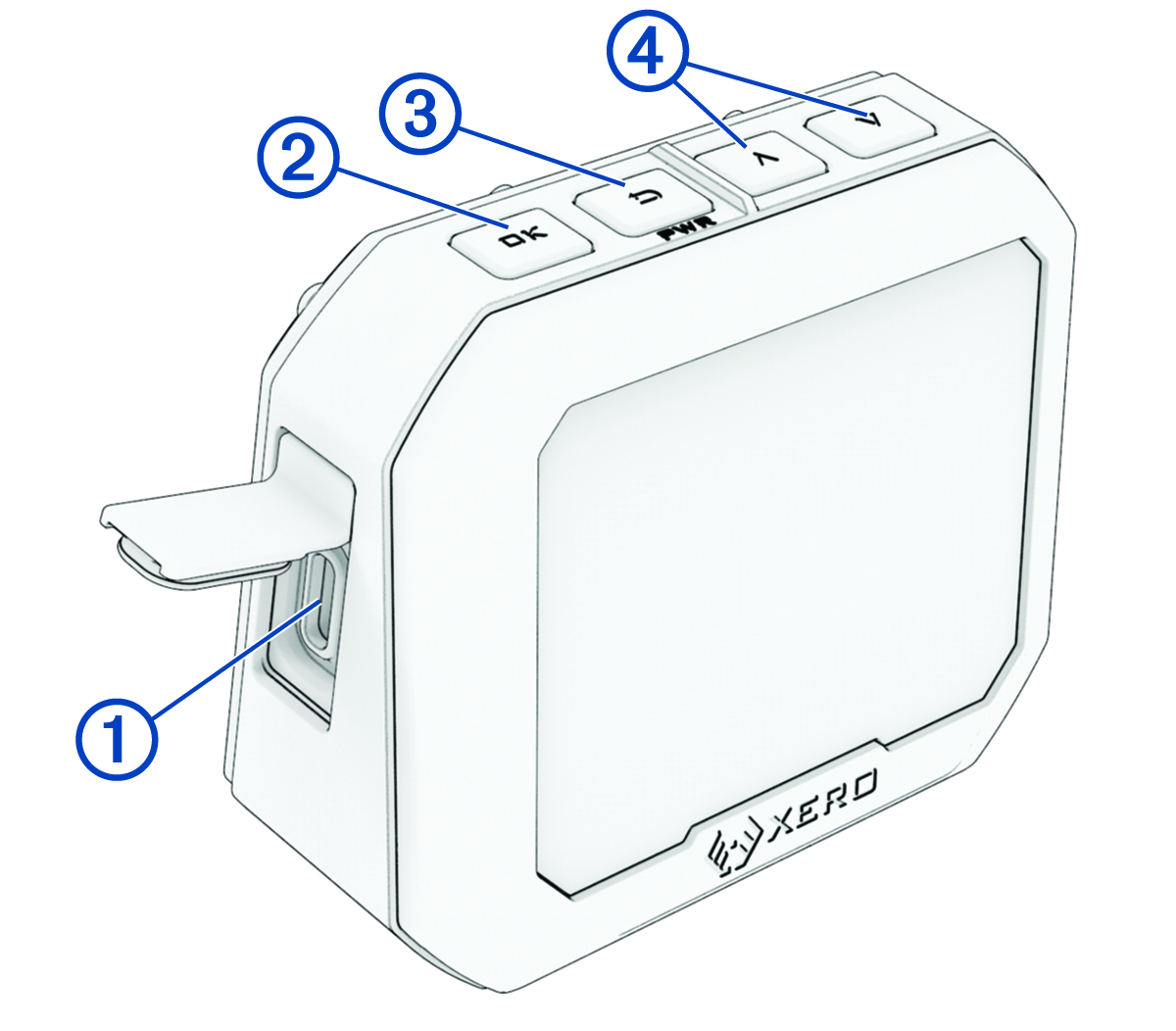

Device Overview
Line drawing of the device with callouts
1 USB-C® port (under weather cap)
Connect the USB-C cable to charge the device or download software updates using your computer.
2 OK
Press to select menu options.
3 Back arrow (PWR)
Press to turn the device on.
Press to return to the previous screen.
Hold for two seconds to turn off the device.
4 Up arrow Down arrow
Press to scroll through the menu.

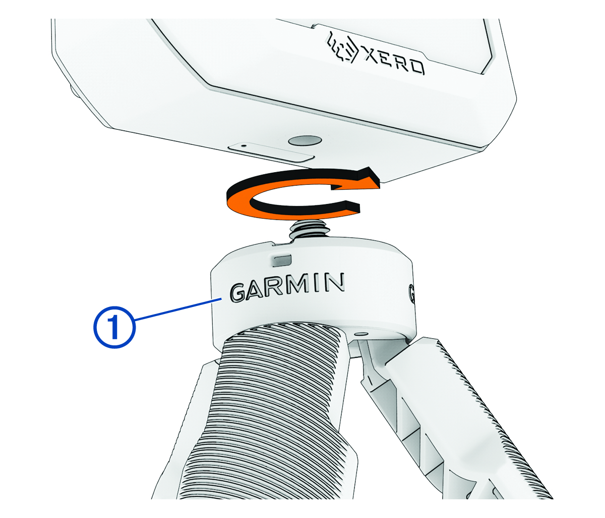

Installing the Tripod
The Xero® C2 chronograph tripod mount uses 1/4 in.-20 thread size and is compatible with most tripods.
Screw the tripod 1 into the bottom of the Xero C2 chronograph.
Image of the tripod being installed with a callout
