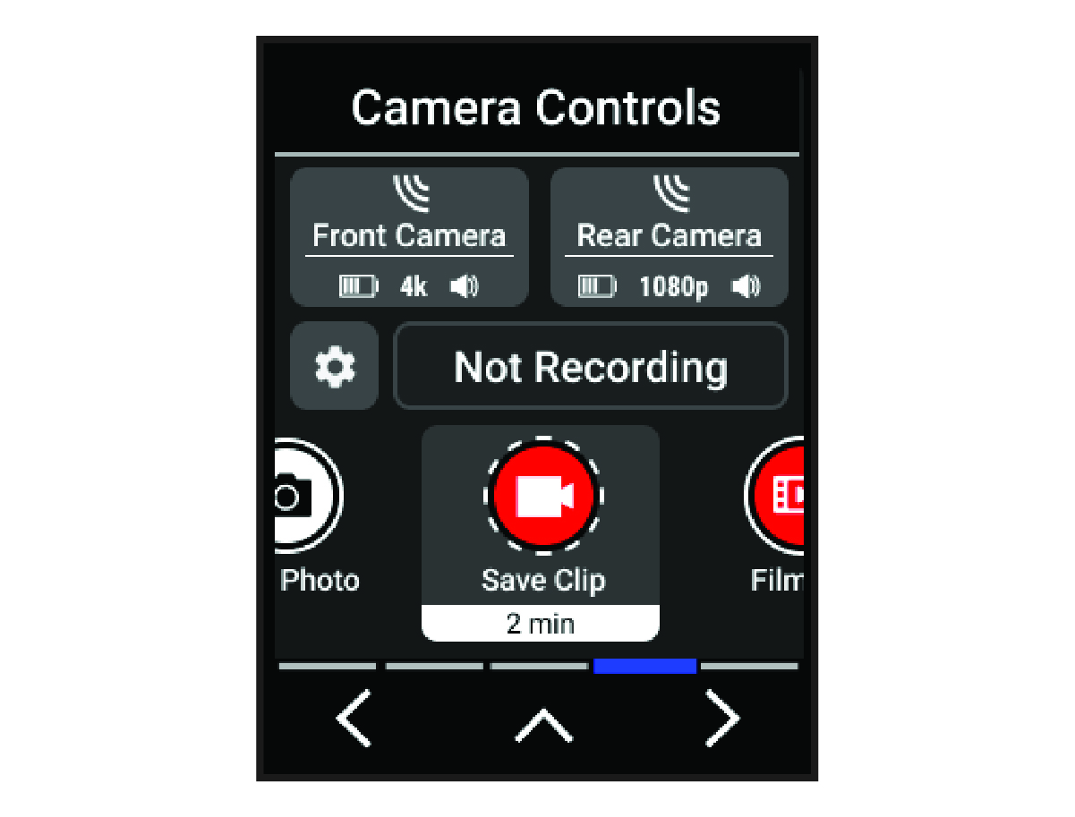

  1. Tap the screen to view the timer overlay, and select Right arrow symbol.
    TIP: You can also control the camera using the quick action buttons on the timer overlay.
    The bike computer displays the camera controls, as well as the recording mode, battery status, video resolution, and audio status of all connected cameras.
    Camera controls data
  2. Select an option:
    • Select Headlight Camera or Radar Camera to customize the camera settings.
    • Select Gear symbol to customize the quick action buttons that appear on the timer overlay.
    • Select Take Photo, Save Clip, or Film Ride.
