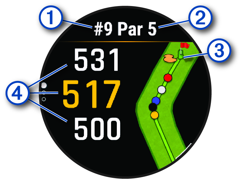

  5. Select a tee box.
    The hole information screen appears.
    Screenshot of hole view screen with callouts
    1
    Current hole number
    2
    Par for the hole
    3
    Map of the hole.
    4
    Distances to the front, middle, and back of the green.
    NOTE: Because pin locations change, the watch calculates the distance to the front, middle, and back of the green, but not the actual pin location.
