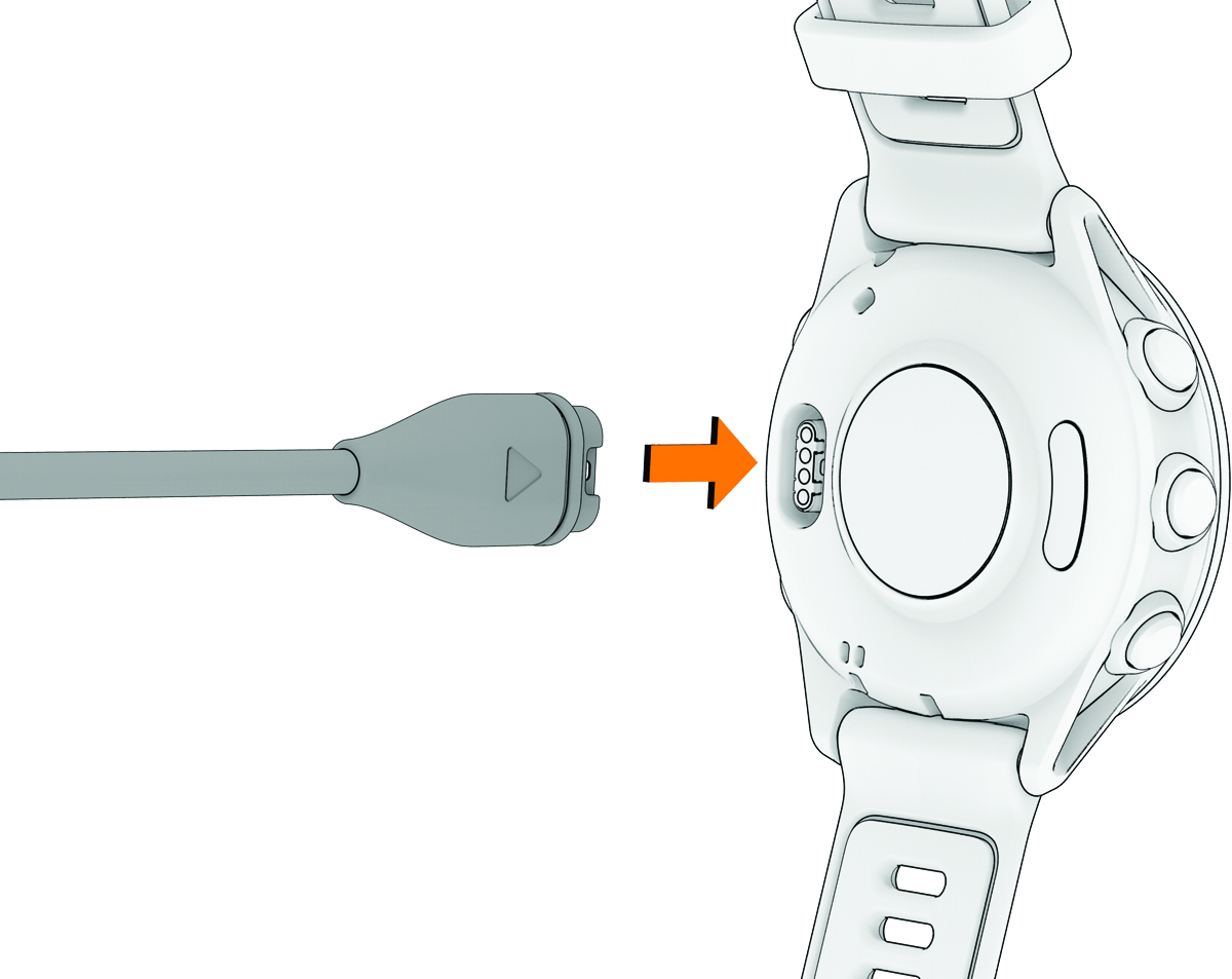

  1. Plug the cable (Triangle end) into the charging port on your watch.
    Back view of the device and charging cable
  2. Plug the other end of the cable into a USB-C® computer port or AC adapter (5 W minimum power rating).
    The watch displays the current battery charge level.
  3. Disconnect the watch after the battery charge level reaches 100%.
